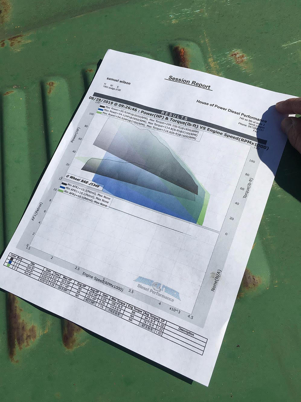

I decided to put my 1963 D100 with a stock slant six on the dyno. I thought y'all might enjoy the sound of it pounding out 55 furious ponies. :lol:
1963 D100: 3-on-the-tree, 3.50 rear, mostly original, stainless bore clutch slave & brake master, rebuilt speedo, original rebuilt carb.

PostPosted: Tue Jul 02, 2019 11:37 pm
Posts: 13421
55 hp? That is pretty anemic. Is it a high mile motor?

PostPosted: Tue Jul 02, 2019 11:53 pm
Looks like it's running rich.

Posts: 9059
Farmtruck states has a flat cam lobe.

Location: Everett, WA
It's all original, sucking air through the oil-bath filter and untouched carb. And has one intake lobe worn to a circle. Given the condition, I wasn't expecting much more. What's hilarious is how little hp it made at higher RPM, it was down to about 32hp by 4000RPM. It made that 55hp at a mere 2700RPM, peak torque was 117@1600. :mrgreen:

Posts: 13421
Well, that explains it. At least you can say you can easily double the output of your engine and have it still be naturally aspirated.

Car Model: '23 T-bucket
Josh, you could do that, but keep in mind what was posted is on a chassis dyno, not an engine dyno.
I suggest still not too bad for a half-worn-out, 60's farm truck.

Roger,
I'm aware.
My 1954 C1 truck's ID tag states 145 certified gross hp and 123 certified net hp. I'm curious to know how much of that net hp makes it to the rear wheels. A highly reliable source states that 88% minus about 10hp should make it to the rear wheels. People claiming 30% drivetrain loss practice a foolish numbers game and will grossly over state the horsepower consumed by the engine accessories to support big engine horsepower numbers. The history of Dynojet's correction factor is telling.
