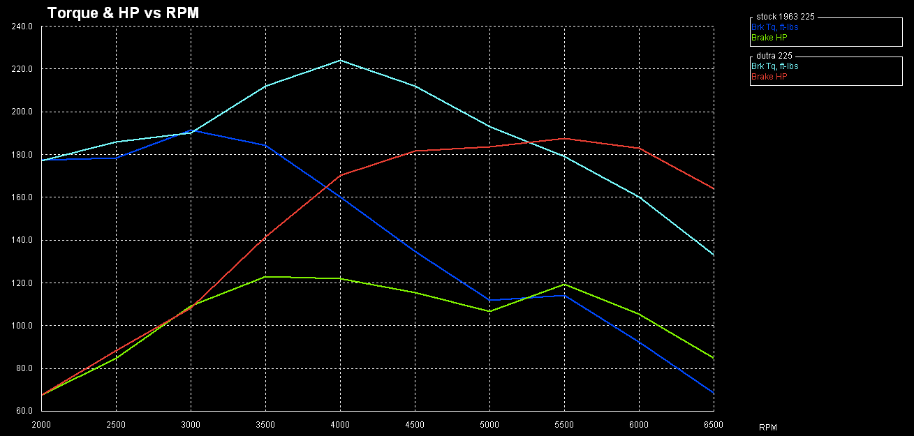

Author:  JimKueneman [ Mon Aug 05, 2019 8:39 pm ]
Post subject:  Re: 225 Engine Build for the Wife's '63 Dart Convertible
Just for fun I put what I think the stock 1963 225 and what SlantSix6 recommend for a build into Performance Trends software to see the difference. A few parameter are guesses but they are consistent across both models. Not a bad improvement!
