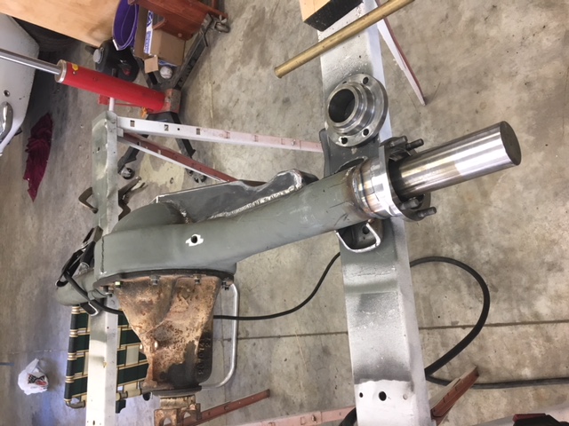

I've done a million of them...doing one now. See attached lol.
I wouldn't go into the SG unless you have reason to think it's bad. The 489 case cone type aren't rebuildable if you go by the book...and the guys who do rebuild them are doing some shaky stuff in order to rebuild them. The clutch type (which is what usually came in 742's) are rebuildable but they are not easy to do.
The axle bearings....probably do not need replacing but if the outer seal is leaking (and it probably is if it's 50 years old) then there is no way to replace it without removing the bearing. And there is no way to remove the bearing without ruining it. I have a special puller for making the removal as easy as possible but the bearing still gets ruined.
The carrier bearings are easy enough to replace but if the rear end had oil in it they are probably OK...especially for a limited use race car. It's not like you're gonna demand 100,00 miles out of it.
If it were me...I'd go into it as a ring and pinion swap rather than a full rebuild. I'd clean up the guts of the third member with Varsol or mineral spirits, pull the carrier, swap the gears, then put it back together using the same bearings and all new seals. I actually prefer a set of used bearings provided they are not worn out. They're already seated and 'proven'.
On the axles....I'd plan to replace the bearings with stock type tapered roller bearings and new seals. You could go with the 'Green' bearings but for a track car that sees cornering...the stock bearings are waaaay stronger.
I'd also add a 1/8" NPT female thread to the bottom of the housing while it's apart. This makes it a hundred times less messy to drain the oil. You can tap the housing itself with good results or...as I do...weld on a small fitting so you have a little extra meat for the threads to ride in.
I'd be glad to help you with the axle bearings and drain plug if you like. I'm not so hot on cleaning parts though lol...
