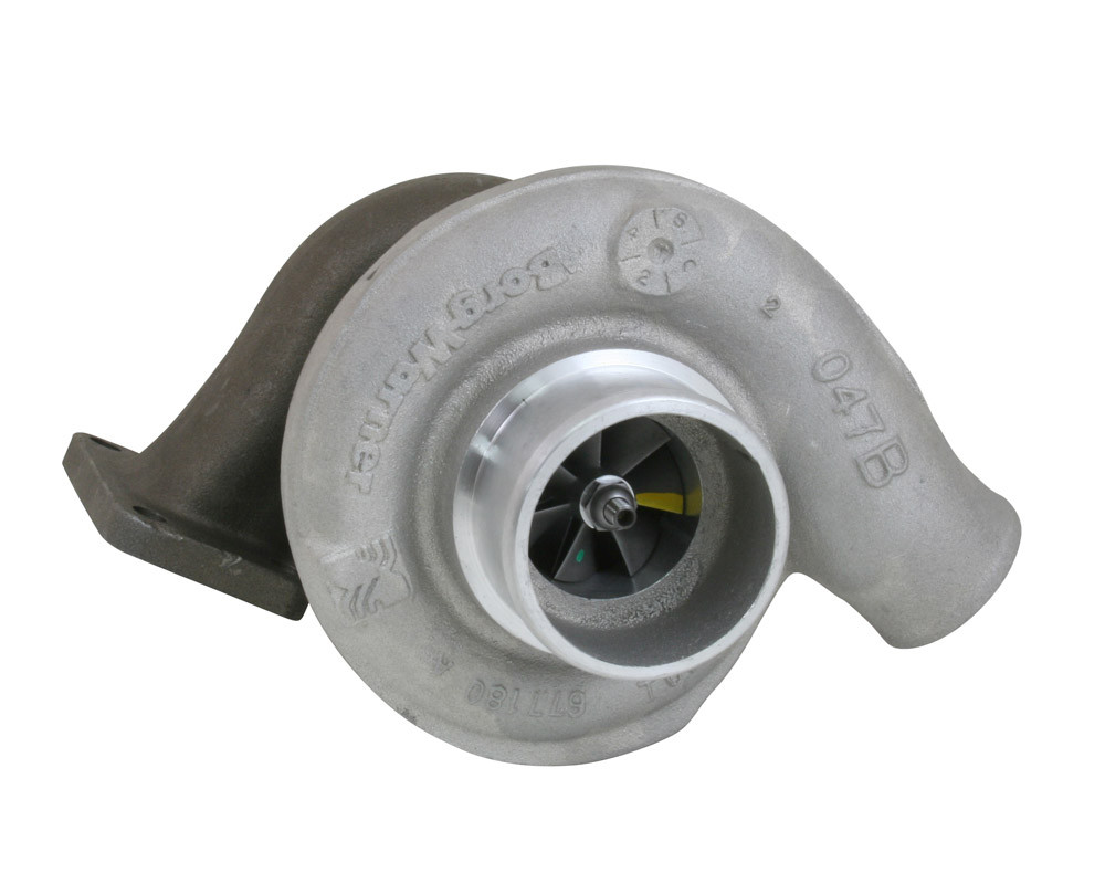

For sure I was going to turbo it but idk if efi or carb will get me in that range? A stronger cam,Cheetah turbo action transmission shift kit and a bigger exhaust. Maybe a super 40,but for the dual turbo set up. I want it under the vehicle to keep the sleeper look.

How much boost can the slant handle
PostPosted: Wed Oct 09, 2019 9:19 am
Done poorly or well? 8)
A poorly done 5 psi setup won't last long. A well done 15 psi setup will last much longer. If you've never built a turbo engine you should expect to make mistakes and get good at changing head gaskets and pistons.
