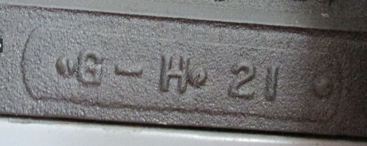

I meant to post this with my response.
My "number" head.
Casting number under valve cover is 2206035.
PostPosted: Sun Oct 29, 2023 6:03 pm
Posts: 24956
Can't help with that one! :?:
