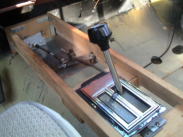

Author:  64 Convert [ Mon Dec 02, 2019 9:39 am ]
Post subject:  Re: Shifters
Mopar floor shifters are versatile from one model to another. My '73 D100 has a shifter from a K-car, and the '56 Plymouth with a '66 transmission I'm working on now has a B-body shifter, year unknown.

Author:  Pgbarrow [ Mon Dec 02, 2019 9:57 am ]
Thanks guys,
So yes, a manual A833 four speed transmission is what it would go on. I will stick with Mopar stuff, but absolutely cost prohibitive to buy the parts individually. I'm going to try and make one tab and linkage for the reverse gear, but am stuck buying the stick. Once I get my book I will start figuring out what else I need.
