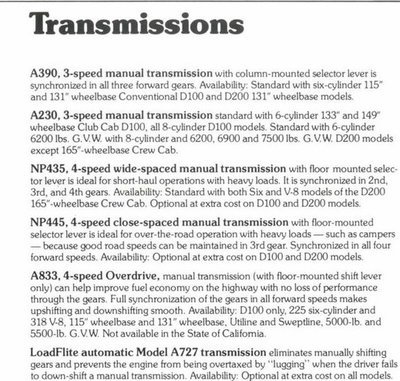

1977 Pickup transmission options from the dealership data book: https://www.hamtramck-historical.com/de ... k-09.shtml
From your field reports it appears that the A833OD availability expanded in later years.
