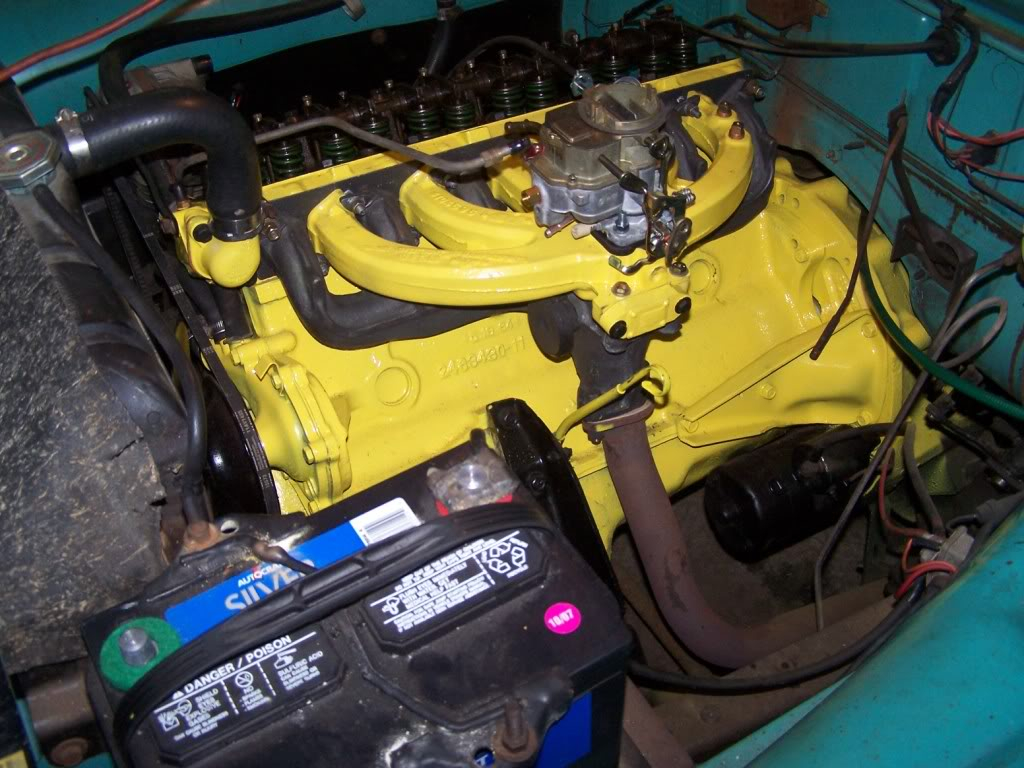

Previously posted at FABO. Was suggested to post here as well. I have a '72 D100 with a slant and NP435 granny trans. I've been searching for pics of the triangular bracket that supports the lower third of the bell housing around the low starter position. My truck's is missing and would explain the crack in the top of the bell housing. If I could find a pic I could easily fab or at least know one when I see it. Rather simply purchase one.
This would have to be the same for every slant powered NP435 truck since 1972.
Thanks -Andrew

Hello Duster. Here's a link to the pic https://www.forabodiesonly.com/mopar/th ... et.458841/
There's gotta be something missing. Every other slant to transmission combo has a bracket. The starter and a full third of the bell housing are hanging in air.
Thanks for the reply. Hopefully this Mystery Science Theater Bell Housing Edition will get solved. I would be open to trying the previous style bell. Isn't the clutch arm window on the passenger side?

Nope, those don't come with a bracket, never was, never did. Just the encompassing lower dust shield and the plate that covers the pocket where the
high mount starter would be mounted on the A-833/three speed bell. (If it had the provision, there would be more bell below the starter, or the bell would be
wider like the 60's version with the bracket. If desired, you will need to put the plates and covers in position and breakout the fabrication skills.
As previously stated Trucks are full framed compared to cars, so the engineers probably thought that the assembly wouldn't flex much at the mating
point between the bell and block...(I have put one of these into an A-body and it probably would have gone better if these was a bracket of some sort...
but they didn't leave any place to mount one unless you fab something that would go to the lower dust sheild bolts, or the Z-bar mount on the drivers
side of the bell.)
Sorry to be the bearer of bad news.
On the previous style the clutch arm and hydraulic slave cylinder is on the passenger side... you are correct.
