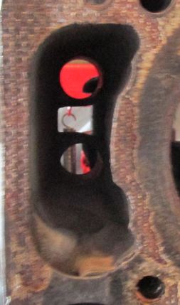

Author:  hyper_pak [ Thu Feb 27, 2020 3:47 pm ]
Post subject:  Re: Esoteric question re: aluminum slant six block compatibility
Some images,
Alum block #6 with old correct gasket, Alum block w/steel shim, Alum block.

Author:  hyper_pak [ Thu Feb 27, 2020 4:34 pm ]
Yes I think we have the answer. You can use later heads on alum blocks with the right gasket. You can use a 75 up head on any slant (ex hydraulic) so it stands to reason it could also be used on a aluminum slant.
