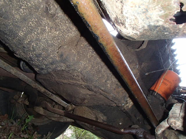

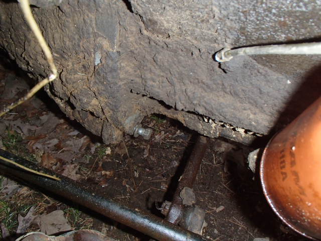

The new NGK ZFR5N is a 1/4 inch longer than the AC and Champion plug that came in this '61 Dodge. Is that going to be an issue??? Took the VC off expecting to find a sludged up engine. Last registered in 12/81 with 57443 miles. Odometer shows 578?? miles. This car has more caked on mud than any car I've owned. I'm thinking this car maybe an original mile car.
