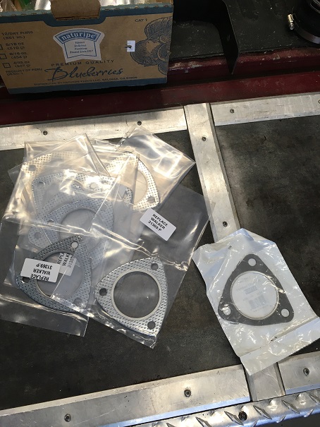

Rock Auto has a sale - close out going on the Walker 31369 gaskets.
These fit the collector flange on Hooker Long Tube Headers.

Do they really have the stainless fire ring, like in your pic? The Rockauto pic has no fire ring, but maybe it is just a stock pic.

The pile of gaskets on the left in the photo that I posted are the gaskets from RA. The packaging says ‘Replace Walker...’
The single gasket on the right is a Walker gasket.
Both sets have a stainless ring at the center.
You are correct that the photo in the listing does not show a ring, but the ring is present on the gaskets that I got.
