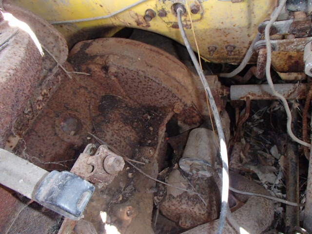

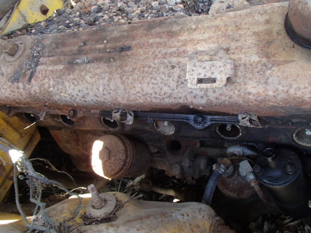

Updated pics

Interesting replaceable element oil filter. And I see a cable throttle retrofit and a dual chamber master cylinder retrofit.

11" clutch and direct-drive starter confirmed (and worth grabbing; don't forget the steel mount plate that goes between the starter and the bellhousing).

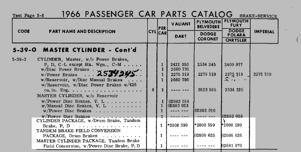

The dual master cylinder might be factory or dealer-installed equipment (see attached). The cable-type throttle is original equipment; the B- and C-body cars with Slant-6 engines got cable throttle for '62. The replaceable-elephant oil filter is a nifty piece; that was optional equipment for fleet cars. Too bad no oil-bath air cleaner (or any other kind) remaining.
