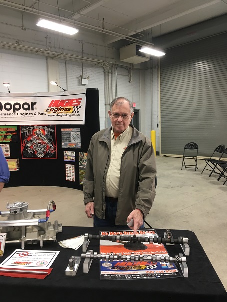

I stopped by the Hughes Engine Booth at the ICH Swap Meet.
They had a slant six cam on display with their other engine offerings.
When I inquired to speak with someone at Hughes that had knowledge of the Hughes Slant Six cam I was introduced to Dave Hughes.
I asked about the tight lash specifications on that cam and Dave's reply was that the lash is tighter because they were wanting to eliminate the typical slant six clatter.
He also talked about the reverse dual profile and putting more duration on the intake, much of the same stuff that Doug D used to talk about
He also commented that like other mechanical cams, one could loosen the lash 2 to 4 thousands and potentially pick up performance. He also commented they have sold several
of the slant six cams and have not any complaints or issues.
He also commented , and this is the important one that they use all Mopar developed cam lobes and he then went into the Mopar 903 lifter being able to support a faster ramp
than cam lobes designed around Chevy lifters.
He also commented that he has many more lobes than what is currently offered on the slant six cams, so if someone is looking for a slant cam other than what shows on the site they can contact him he would do his best to go through what he has to come up with a Mopar lobe that matches what is being requested.
Throughout the conversation Dave H seems genuinely interested in the slant and was happy to stand there and talk to me about it.

It is nice to see that Hughes is supporting more SL6 stuff and It looks like they followed some of my advice on Slant Six cams. (Slants respond well to reverse dual patter cam grinds)
I am not sure why Hughes is using lobe profiles with such tight lash ramps because that can be problematic for a solid lifter Slant Six, especially with the exhaust valve. ( lot's of expansion there)
Time will tell if these new grinds work well.
