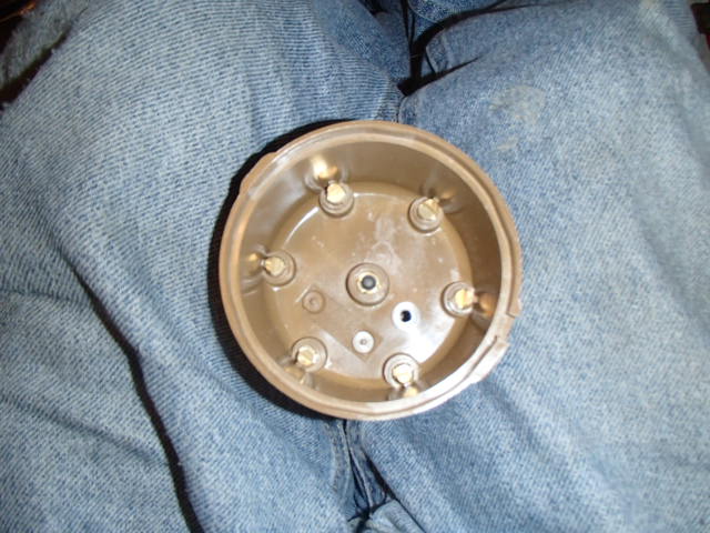

Dan here are 2 pics

Tough to tell from here. Look at all six of the brass lugs, see how they're ground down from a full circle? You're looking to see if they're all pretty much the same half-circle. The off-centre ones have some as a smaller sliver and some as more than half a circle.

Dan, the plastic down around the base of the brass posts have slivers of brass and plastic hanging. I can defiantly see that the brass posts have different circumferences. What is my next option for a cap??? I finally got my VC gasket from NAPA and it ended up being a cork instead of rubber. I'll make it work.
Amazing. I first noticed this problem on the Echlin MO-40 caps around 1992, and sent a couple of them and a detailed letter to Echlin at that time. They said "we don't see a problem with 'em". Nearly two decades later, they still don't give a carp.
