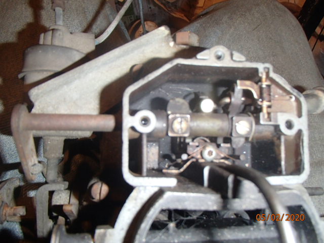

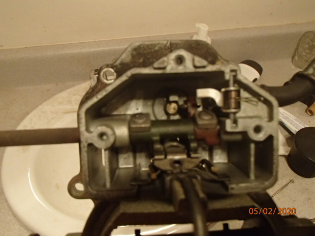

This 1st pic is the one off my '79 Aspen . Its like your pic. However, the 2nd pic is the carb off my 27k mile car. The top is not attached to the body of the carb so the accelerator pump is not pushed up. Is that my problem???

The pictures are reversed.

Posts: 1603
Get the plastic arms in place then slide the shaft in.
 Post subject: Re: 1979 Super 6 Carb
PostPosted: Sat May 02, 2020 6:11 pm
Posts: 1603
Quick answer yes. The book says to place pump drive spring on plunger shaft and then insert shaft into air horn. Compress spring far enough to insert S link.
