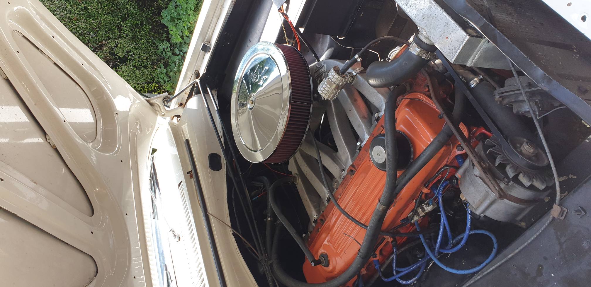

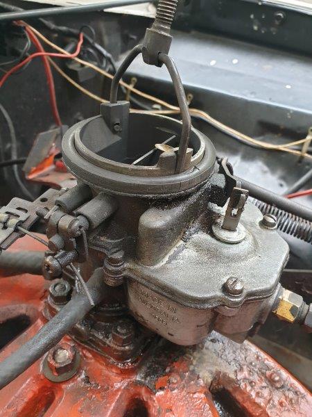

Hi all,
So I've gone ahead and done the work outlined above.
My car is an Australian built 1967 VC Valiant. The engine casting no. is 330 4 29991 - which makes me think that the slant is a later model slant than 1967. The stamp behind no 1 looks like O 22 R 1980 E.
Originally it had 2 barrel BBD Carter Carburettor, manufactured by Email Ltd in Australia (which was an Australian company that made these under licence) and is a stock VC Valiant as they were built in South Australia. (photos attached for those interested)
Over the past week I've had the following installed by the boys at TMS Racing in Kapiti, near Wellington, NZ:
* An Aussiespeed Hurricane Long Runner intake manifold
* A brand new 07448 - Holley 2300 350 cfm carburettor (I originally wanted to keep the Carter BBD but for various reasons that did not happen)
* Dual Dutra Duals front and rear
* Remflex manifold gasket
* 2 inch pipe from the Dutra's to a Flowmaster 2 inch in 2.5 out Y connector scavenger pipe
* 2.5 inch straight out the back through a Flowmaster 50 Delta Flow.
* a set of 6x new spark plugs (NGK BPR5FS)
The slant fires fine, looks cool, sounds great, revs up ok but is missing on the no. 6 cylinder under throttle and at lower revs/idle. It's possible to drive through this and by 60 - 80 mph it seems fine unless you put your foot down too heavy. It's worst at about 40 mph. Our guess is either the points or perhaps a lash adjustment on No. 6. Also no six exhaust temp on the dutras is a lot cooler than the other five.
I'd be welcome for suggestions as to possible cause and fix.
Thanks for your help
Cheers
Mark.
These aren't calibrated out of the box for a 6 cylinder or even worse a long ram intake application... you'll need to tear it down and change the base jets to 58's,
change the acc pump cam to orange and see if that helps performance... performance would be better if the engine was 9:1 SCR with an RV cam and some port work...FYI.

It looks like you have the PCV valve hooked to the number six intake runner. That will make that (#6) cylinder run lean. Reroute the pcv to the connection on the carb, and plug the fitting on the manifold.
PS: I would be concerned about the fuel filter being tied to the intake. Might rub a hole in the plastic.

We down jetted to 58s when had it on the dyno. I tightened up the no 6 exhaust valve lash a bit and that helped a lot. Running reasonably smoothly but bogs a bit at WOT and still a bit missy in the 40 - 50 mph range.
I didn't think about the PCV hose being in the a different place. I'll see if moving it makes any difference.
As for the fuel filter, that was very temporary. No idea why someone thought that was a good idea. Had that sorted straight away.
