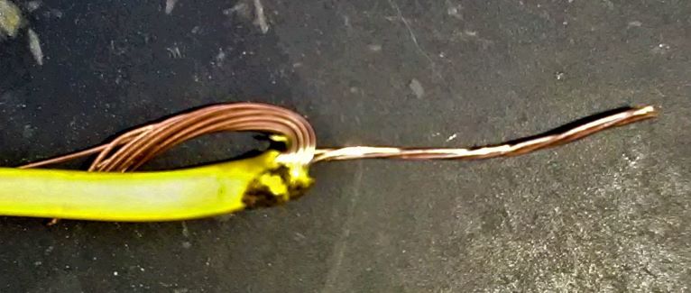

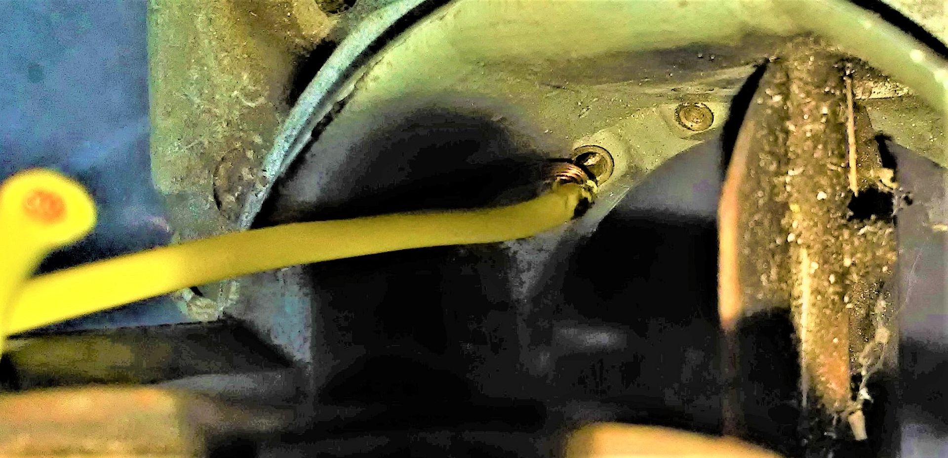

Plug pvc hose, got power brakes?,plug that too. Tighten bowl cover screws,air leak into idle circuit. Block off air to idle air bleed. Image
 Post subject: Re: RPM diagnosis
PostPosted: Tue Apr 21, 2020 7:01 pm
Posts: 1603
PostPosted: Tue Apr 21, 2020 7:14 pm
Posts: 1603
Blocking that hole will increase vacuum and make idle richer, good place for carb cleaner too. After hole is blocked see if it will idle slower then,may need mixture adjustment.

To the left of yellow arrow is idle down channel, to the right is idle feed tube probably clogged up
