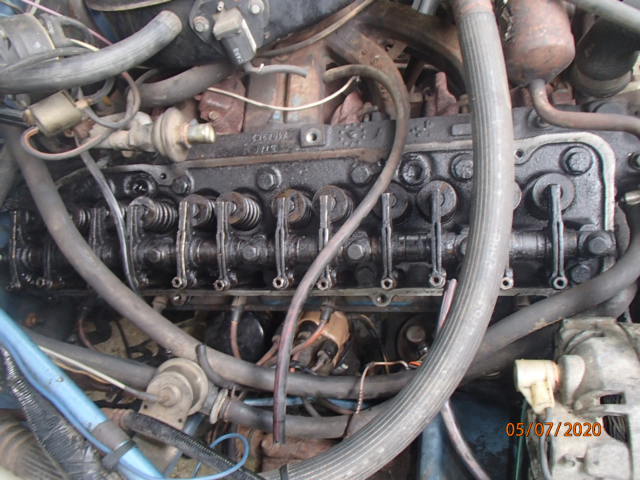

Thanks for the quick response. 27k original miles. It has adjusters. I have to rig up some hose and wire pull ups. Its not like adjusting valves in my '61 Dodge Seneca with all the room in the world.
