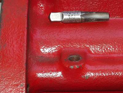

Hello All.
I would like to install a true oil pressure gauge on my 62 sweptline pickup with a 225.
I have the low pressure indictaor light in the dash. But would also like to have a true gauge to see exact readings. Is there a second tap into a oil galley to install a fitting for this. Or is there another way you would achieve this. I would like to keep the factory indicator light and just have a 2nd gauge.
Thanx.
Jim C.

Or check to see if the rear oil gallery boss is drilled & tapped.
