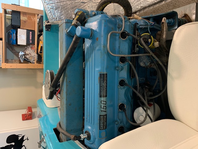

Hello to all, I’ve been enjoying learning from this forum for many things its been a great resource as i become familiar with my engine. I need a little help and am not finding exactly the info in any existing thread so this is my first post. Thanks to all in advance for any help or advice you can give.
What I have: M225D original to the 1968 SilverLine DeVille 17’ boat it is in. It has a Carter BBS (tag missing) with electric choke. A Chrysler type distributor (marine style with no vacuum advance).
Condition: mostly original with low hours as far as i can tell with basic wear items having been replaced. Runs. Starts easy cold or hot. Idles well at 850 - 900 RPMs. Accelerates smooth if done slowly. Cruises at 2000 RPMs all day with no issues.
What’s been replaced: Cap and rotor, points, condenser, plugs, wires and coil.
What’s been recently adjusted or checked: timing (with a light and by vacuum), idle mixture screw, choke
Problem: the engine dies/ bogs when throttled quickly from slow speed (1000 - 1200RPMs), bogs but sometimes takes off when throttled quickly from 1800 - 2000 RPM. It will go from 1000 RPM to full throttle smoothly with no issues if done so slow and smooth. The behavior is similar in neutral under no load but not as pronounced. Basically punching it kills it.
Any help or insight would be great or get out of here you boating fool is OK to, there just isn’t any slant 6 marine fanboy forums for me to join :P

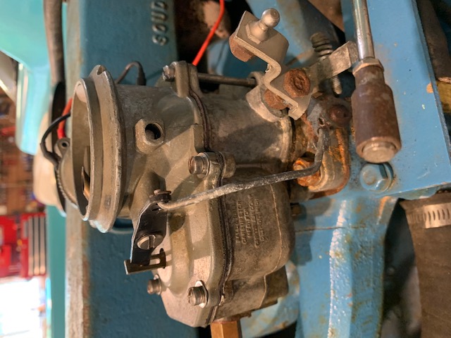

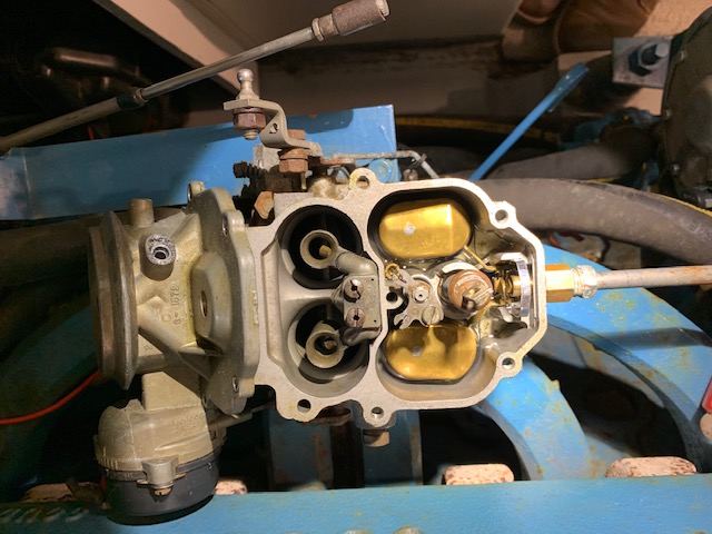

I checked the function of the accelerator pump. No stream, so I the top off the carb and operate the pump by hand and fuel seems to squirt around the pump cup/ seal back into the bowl. I'll be looking for a rebuild kit.
I've put some pics of the boat, engine and carb so you guys can see what you are helping fix and to assit in more expert identification of the carb.

PostPosted: Tue May 12, 2020 1:22 pm
Carter BBD. If the leather on the accelerator pump cup is in fair shape you can soak it in light oil so that it softens and swells enough to conform to the pump bore. Also, there needs to be a check ball in there so that fuel isn't pushed back out the pump inlet. This works like a squirt gun. There has to be a check valve between the reservoir and the pump so that the discharge goes to the nozzle.

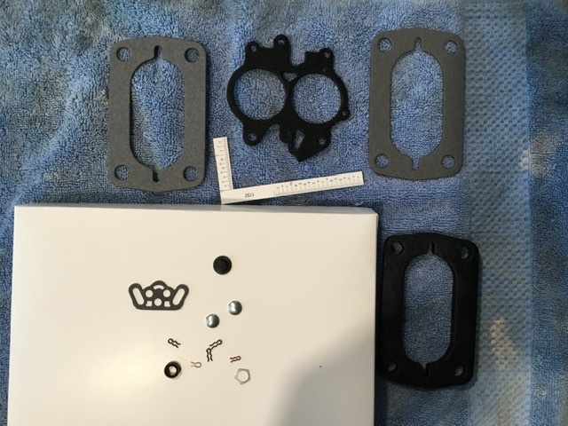

OK Gang here’s the results. I rebuilt the carb and went for a test drive. The problem was resolved. You can now hit the throttle and it jumps right up and goes. If you do it fast enough to there is a slight pause but it doesn’t die.
I’d did discover the cause of the issue during disassembly. It was a stuck check ball in the venturi cluster not allowing the squirt from the accelerator pump to flow.
It runs smoother at idle and lower speeds as a result of the squeaky clean carb. BONUS!
Now the bad news. It did accentuate an issue i was not attributing to fuel flow. Prior to the carb rebuild during 70% - full throttle operation it would occasionally skip a beat but not die or really stumble significantly. It would quit for a split second then resume normal operation. It would happen once every 10 - 20 minutes and changing the RPMs a bit always stoped it. Now this is happening at at 50%+ throttle and more frequently.
Thank you all again for the help. I’ll seek info on the other issue on other threads so this can remain about the issue in the title.
Now back to work on that cool engine!
File comment: Also here are the leftovers from the kit. If anyone wants them PM me and I’ll drop them in the mail.
