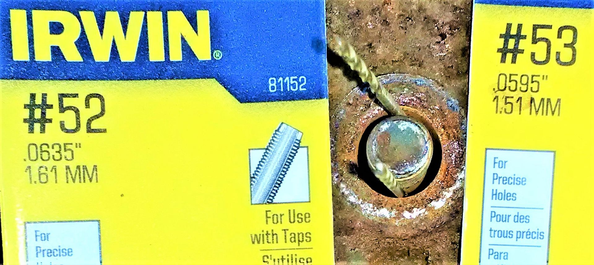

| Author: | matv91 [ Sun Jun 07, 2020 4:06 am ] |
| Post subject: | Re: No idle after intake reseal |
https://www.slantsix.org/forum/viewtopi ... it=exhaust This was bulletin about replacement manifolds. Instructions say to check hole in intake manifold, 27/64 drill bit. |

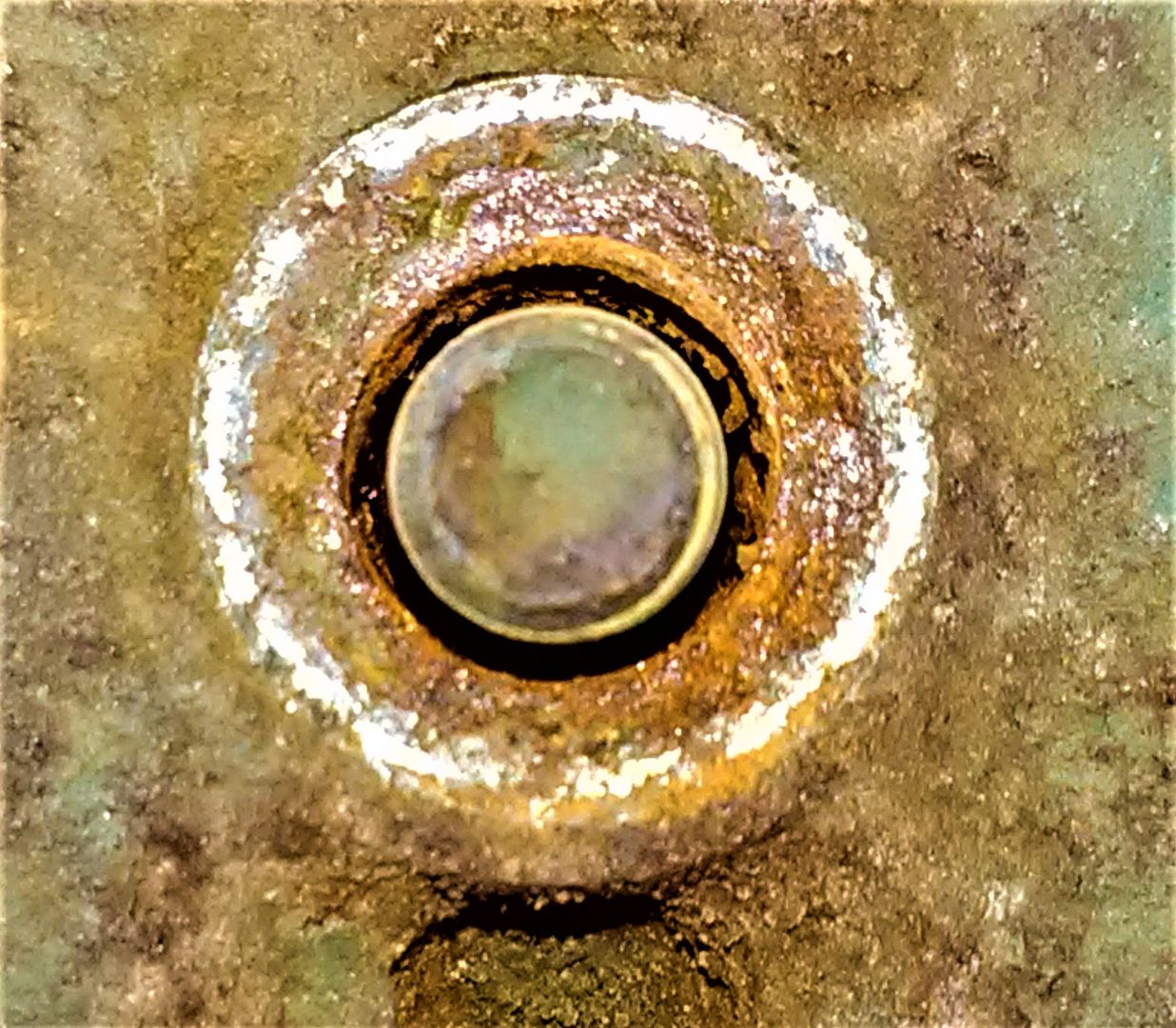

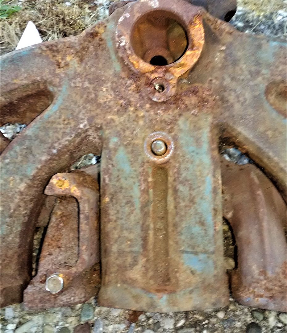

| Author: | matv91 [ Sun Jun 07, 2020 7:32 pm ] |
| Author: | matv91 [ Sun Jun 07, 2020 7:34 pm ] |
| Author: | matv91 [ Sun Jun 07, 2020 7:35 pm ] |
| Author: | matv91 [ Sun Jun 07, 2020 7:49 pm ] |
Slightly off center,top drill bit number 52 bottom bit 53. Room for movement any direction. |
