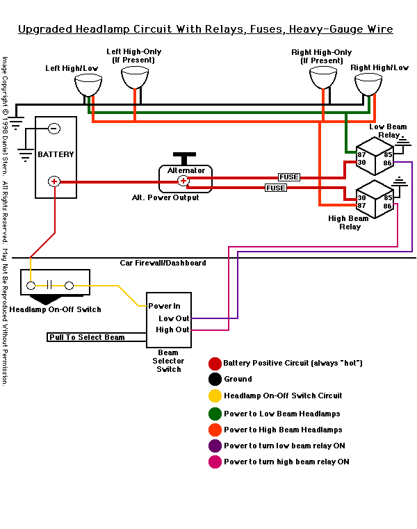

Planning on changing the headlights to relays since I have headlight flicker after updating all my ignition etc. my headlights and instrument lights flicker. Is the right diagram or do I need to look more?
PostPosted: Sat Dec 14, 2019 10:17 am
Posts: 25053
That diagram is from my website. It's for a 4-headlamp car; the linked page also has the correct diagram for a 2-headlamp car. Also see here.
Thanks Dan :D
