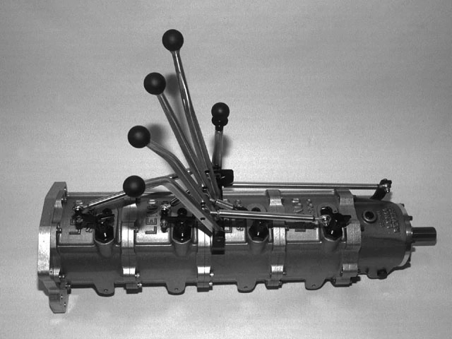

Just for fun...here's my latest acquisition...a Lenco 5 speed. Ratios 2:99 / 2:17 / 1:57 / 1:25 / 1:1 No overdrive but also not a lot of drop between gears....
PostPosted: Mon Jul 06, 2020 6:07 pm
Posts: 2612
You dog!
Man I love that Lenco, seriously cool part.
What are your plans for the trans?
PostPosted: Mon Jul 06, 2020 6:38 pm
The real downside to the OD 3:09 trans is the big drop between 1 and 2. Otherwise, it's quite good.
With the 3.09 1st gear the drop to 2nd is 62% of the pre-shift RPM. With the 2.66 1st it's only 72%. But with the OD it's a nasty 54%. I ran the 2.66 1st gear 4-speed with 3.55s and short tires. That worked fine.
Those are nice close ratios. Lenco's are bitchin' so long as you're on the throttle. For those who don't know, there's no engine braking. I'm more into road racing so I'd rather have a sequential dog box or a dual-clutch. I'm not willing to spend that kind of money so my ZF 6-speed will have to do.
