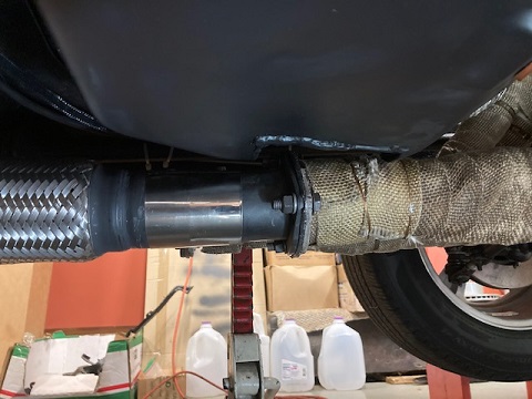

The long tube Hooker header flanges get real close to bottom edge of the deep 904 oil pan. I am working on re shaping the pan in one section to allow for proper clearance.
The cut out provides ample room, my welding skills are adequate, but to get this done the best way possible, I have a few questions.

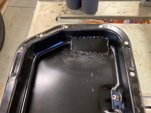

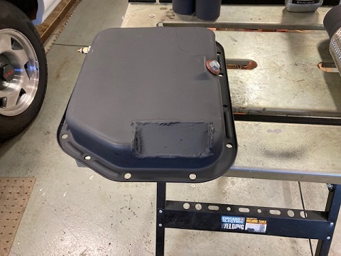

Welded the plates in on both sides as recommended,
then checked for leaks with water, there was very slight seepage that would wet a paper towel under the part after an hour +.
I then applied a coat of the Loctite 290 on both sides, that is the wicking Loctite that is intended for sealing welds or locking threads on parts already assembled.
Rechecked with water and there was no seepage.
https://www.henkel-adhesives.com/us/en/ ... e_290.html
For an an additional sealing I painted the welded areas with a coat of red Glyptal
Then sprayed the pan with black enamel
