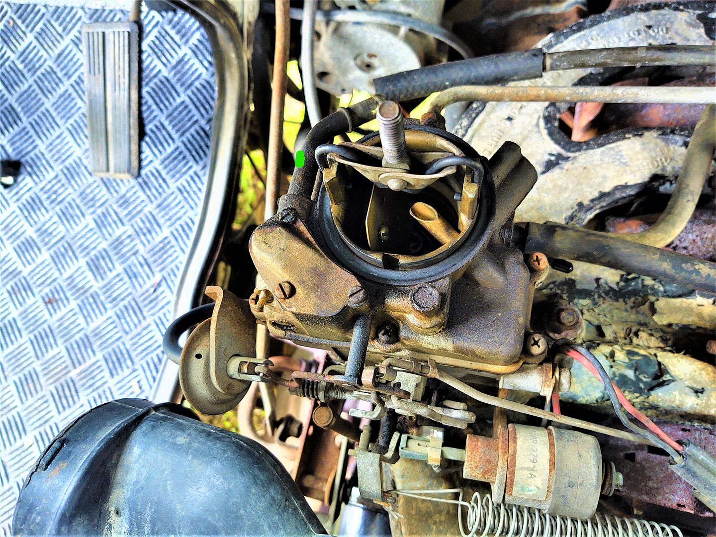

Sorry I cant unload this photo until I shrink it down. So I've uploaded it to my Google Drive.Vacuum advance at idle is not necessarily a bad thing. If the cam in the motor has a lot of overlap or the stock motor gets a lot of egr at idle, using manifold vacuum to bring in vacuum advance at idle can really help to smooth out the motor at idle. As soon as you step on the throttle and open the throttle plate the manifold vacuum equals ported vacuum. You mention that you have two ports above the throttle plate on the carb that you have, those will be ported vacuum that do not have vacuum at idle. And I thought that the PVC connection to the carb was always below the throttle plate. Nice job on the video. For the HEI modules, I also went through a couple of modules, then I paid extra for the Genuine AC Delco module and it has been fine. I bet that if you get a used OE module out of a pull a part it would be old, but good. https://drive.google.com/file/d/1JTg45g ... sp=sharing If you look at the port that the tubing is crooked looks like it's coming off the fuel bowl. There is another port about the same size hose on the other side. If I disconnect either of these hoses, the engine idles fine. If I disconnect the hose on the right side of the carb, I can't feel any vacuum at idle but if I rev the engine, I can feel vacuum. I have not confirmed this with a vacuum guage but looks like the right hand port would be OK to tap into for a vacuum signal to my vacuum advance. The hose connected to the crooked piece of tubing I cant feel any vaccum on this port. |

Green dot is bowl vent

No, Chrysler just called it "Electronic Ignition". HEI was GM's name. The HEI module is a better pick; you're on the right track there.Quote: I don't see why I couldn't knock out a Welch plug and drill and tap the hole for a fitting
About a 99.8% surefire recipe for ruining things. That hole is not randomly sized, shaped, or placed; all three of those aspects are super crucial to how the engine runs. It's not something that can be guessed-and-goshed in the garage with a drill.Quote: If you look at the port that the tubing is crooked looks like it's coming off the fuel bowl. There is another port about the same size hose on the other side.
Carburetor operation and repair manuals and links to training movies and carb repair/modification threads are posted here for free download. Head over there and get a nose into the materials relevant to the Holley 1945. If you're going to even consider the idea of making your own modifications, you really need to start by knowing what the carb's various ports are for.Quote: If I disconnect either of these hoses, the engine idles fine.
If the engine won't idle well with the bowl vent hose connected (Matv91 has identified it for you) then there are problems that need to be found and fixed. Quote: have not confirmed this with a vacuum guage but looks like the right hand port would be OK to tap into for a vacuum signal to my vacuum advance.
No.
