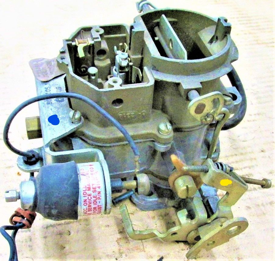

is there a source for the Idle Stop Solenoids that were used on the 78ish-88ish BBD Super Sixes and 318's With A/C?... THe little doohickey that kicked the idle up ~200 RPM when the A/C compressor was running. It seems I cannot locate a good part # for them.. but might Have to use something listed for a GM car.... there are listings for those. Greg |

Blue dot bracket, yellow dot different throttle to match solenoid,carter part number 213-166A 1979 slant six with ac |

https://www.ebay.com/itm/318-360-CARTER ... 3307241415 Bracket and solenoid |
