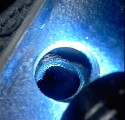

Looking at the photos, if there is no water jacket in that part of the head it would seem really simple to drill the head for injectors. Does anyone know if there is water over there?
Yes, there's a water jacket around the intake port.

PostPosted: Tue Jan 04, 2022 11:39 am
Posts: 798
Location: Rio Rancho, NM
It can be seen in this photo
