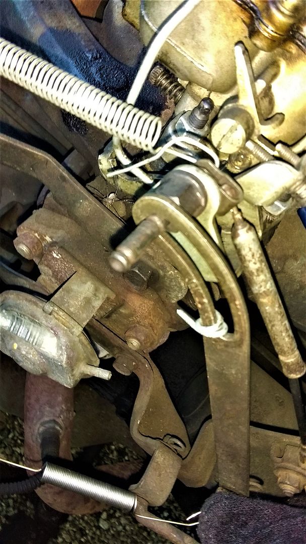

Light spring should keep that Rod up against the throttle pin all the time normal operation, all Throttle positions. |

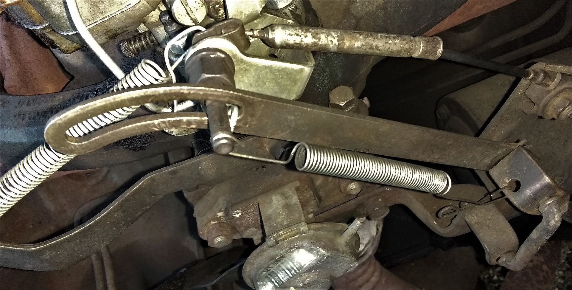

And this picture car was at Full Throttle, kickdown linkage has seized or failed somehow either internally or externally. Will not return to curb idle. Throttle return spring has overpowered the kickdown spring and safely returned carburetor to Curb idle . Fail safe. |
