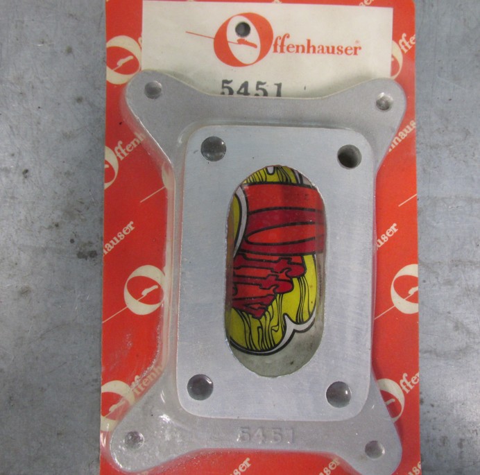

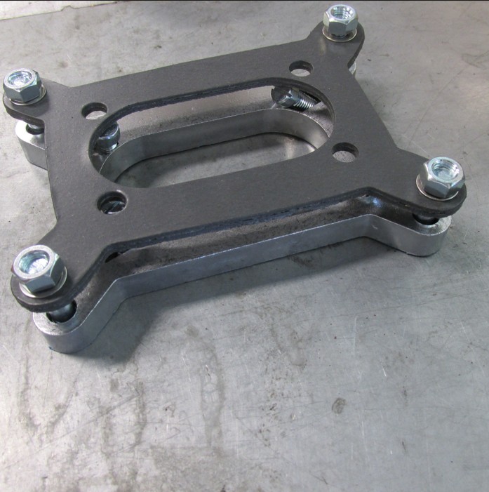

I have 2 types, an Offy and a chinese one that I got from Summit I think.
The chinese one is a lower profile.
You would need to check what direction your linkage is going to run and see which one works better.
