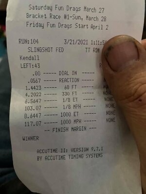

Jeff Kendall, our 2020 National Champion AND Rookie of the Year, just blew away his best time in his SDRA dragster.
He’s gonna put that AA/Gas record out of reach for us mere mortals.

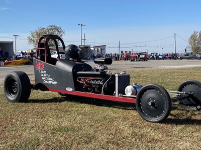

No quarter mile time?
Can anyone post a picture of his 'car'?

Posts: 9166
PostPosted: Tue Mar 23, 2021 9:59 am
Posts: 147
Location: Owasso OK
Car Model: SDRA Dragster
We were not running the quarter mile at the Spring Hot Rod Reunion, only 1000ft in Slingshot/FED class. The SDRA class also ran the 1000ft with a 9.50 second index. I took runner up in FED. I totally botched my dial and broke out in the finals.

Hi Jeff,
Very exciting. Nice work on the basics and making a super nice combination of engine/drivetrain mods and car. Seems like you'll be well into the 9s with that 1000 ft ET!

At 2000 lbs, the ET computes to 350HP, the MPH to 340HP
All I can say is WOW! Just awesome.
What would you say is the weight of the car?

Before a little weight reduction over this past winter, the car weighed 1359 race ready with fuel. Without me of course.

Could you post some more pics of your car? I would love to know more about it.

What specifically do you want to know? Engine? Chassis?
You can look up SDRA Tulsa on Facebook. SDRA is the class I built this car for. (NA inline engines)
There are pictures of the chassis build there. You have to scroll down a bit.
The engine is really nothing special. Just real high compression with flat top pistons. Milled the head way more than most would dare. Zero decked the block. Notched the pistons to match so the notch would be as small as possible. Now about 14.5:1 CR. Running 112 Racing gas. Carb is 650 brawler. No mods. Head is mild port (just clean up really) with 1.75 intake and 1.50 exhaust valves. These are the ford pinto 2.3 valves. Cam is from Racer Brown. Not the biggest cam I could go with, but pretty big.
904 trans with minimal mods. Low gear set from late model trans, TCI reverse manual VB, BTE 8" torque converter, medium depth steel pan (Mopar reproduction).
Of course I run Magnacore wires. The distributor is locked out. I use the Pertronix Digital HP ignition with matching coil.
Stock volume oil pump from Rock Auto. I did lap the drive gear and cam before final assembly.
Double roller timing chain (BB)
ATI harmonic balancer (BB)
I built the headers myself, collectors are from Burns Stainless
Water pump run by Moroso electric motor with custom bracket I made
Radiator is a cheap eebay special for Hondas
Water pump is AC delco from Rock Auto
Roller Rockers (unkown brand, but rebuilt by Rocker Arms Unlimited in CA)
Custom push rods (Smith Brothers)
What else?

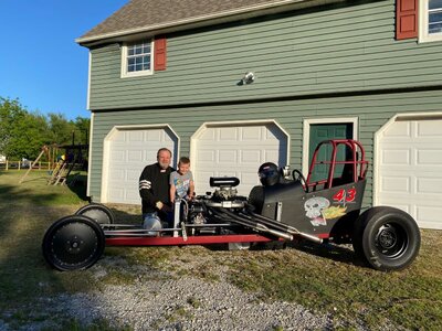

Here is another pic

Thanks Jeff. That is good info. I am a big fan of the FED cars, especially when slant motivated.
I rechecked the HP calculator:
@ 1600lbs: 272 HP-(mph), 279 HP (ET)
Not to shabby my friend.
Do you have any plans for upgrades later? It looks like you are well on your way to the record books.
Congradulations, well done!
