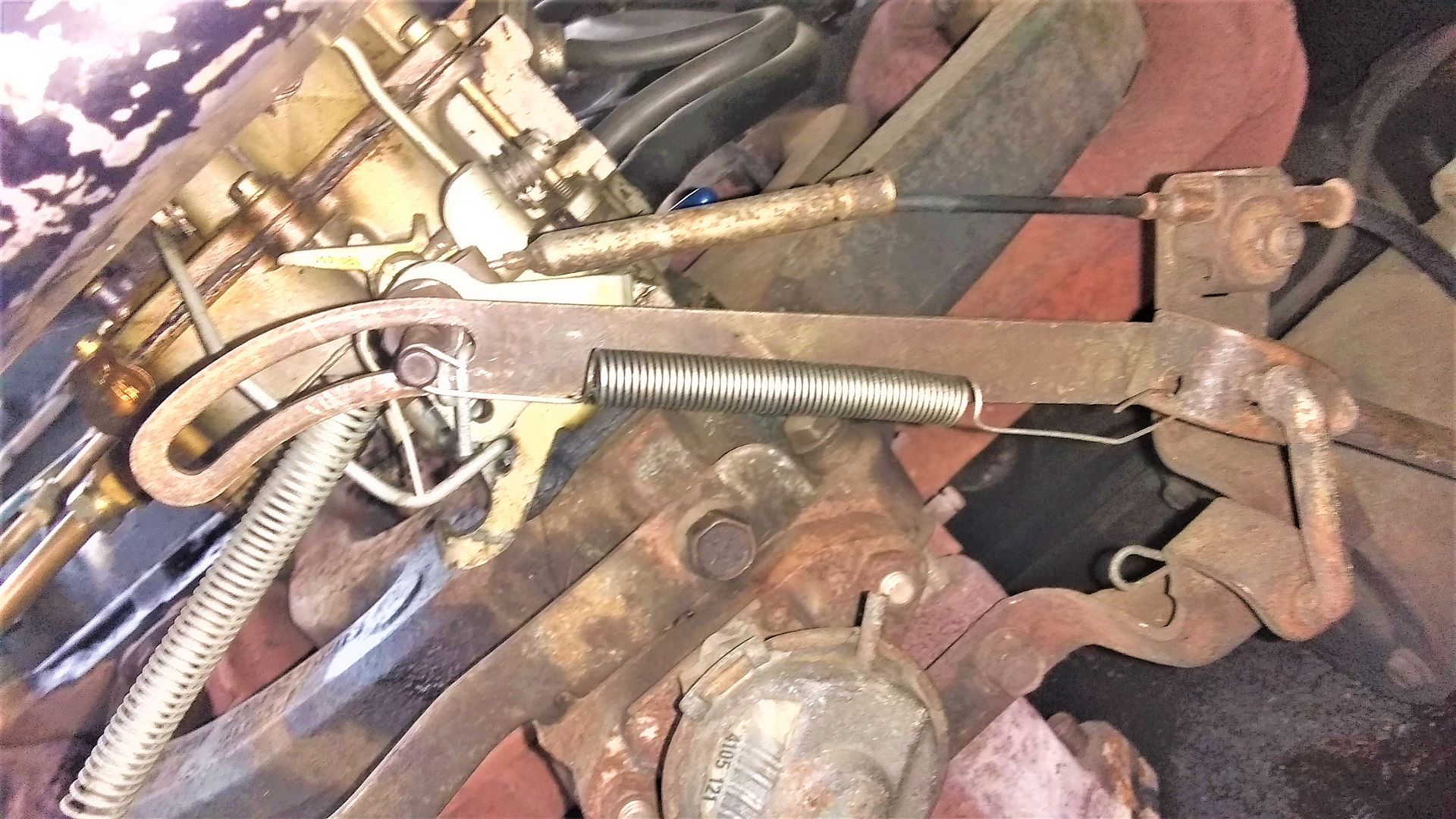

Forgive my ignorance....Can anyone positively ID this kickdown as being correct for the 2bbl BBD Super Six? It is from a 79 Volare/Duster. ![]() ![]() ![]() Thanks |

Looks like the right one to me the top one in that image is for the two barrel. The big question is do you have the rest of it |

This is what I have currently installed

yes that look right |

Black is where rod goes don't forget the Green Spring |

Use the one on the right a different D angle it'll throw it further forward. your original one the car came with might not be correct for this application |

Thanks for the response! Issue is..I don’t have the kickdown rod...through I did. The photos I shared originally were of a rod I can get. I have all of the other brackets already assembled...the second set of photos are of my engine. The person that has it is unsure if it was from a 1bbl or 2bbl. In 1979 would the two rod have been very similar? To me, the original one does NOT look like the super six rod. The bend looks different. But then I don’t know what the 1bbl rod of that era looks like. It would have been a 1945 carb I think in 1979. |

bends different still looking |
