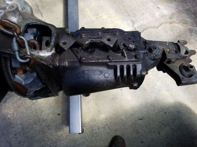

I recently acquired an low mileage '72 slant with this manual transmission/new clutch/surfaced flywheel attached. I have no use for it whatsoever, but maybe somebody does. I'd like to identify it, and request some advice on a fair asking price for all three components as a package. I've got some questions about the engine as well, so I'll post those in the appropriate forum section--just to break tradition with most forums on the net. Based on the condition of the engine, I'd be willing to guarantee this transmission was never abused, and probably received proper maintenance. I believe I heard him say it was a 3 speed, but I'm not certain of that since I was primarily focused on the engine.

That angle makes the levers and side a bit odd.. Maybe share a picture of the Top, Yoke area - is it a slip yoke or a fixed yoke.
It's a 3 speed, but I am not sure what model / Production code it would be.. I have never seen one short and with the ribs on the bottom of the case.

Yeah, I did a fair good bit of looking around on the web, before deciding to ask for help. And I didn't find anything that really looked exactly like it. Here's another pic. I'll look for some numbers on the trans next time I'm at its location.

I don't know the model designation, but it looks like a 3 speed all syncro columm shift. For a 4 wheeldrive truck. Has a rear sump oil pan on the engine, and it looks like the yoke on the trans is bolted on, for a drive shaft to a transfer case.

My 1974 D100 had the same transmission. It's a fixed yoke transmission used with a two-piece driveshaft. Or possibly a divorced transfer case four-wheel drive, but those disappeared by the 1970s. If someone needs one it's probably worth $200, maybe more, but the demand is going to be very low. The standard 3-speed in 1972 was the A250 unless you had a crew cab and then it was the A230.
