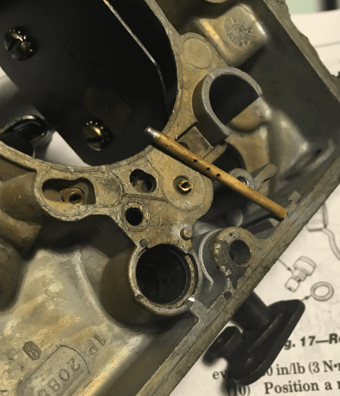

File comment: Broken main well tube

My idea is a one step smaller brass/copper tube that just fits inside......

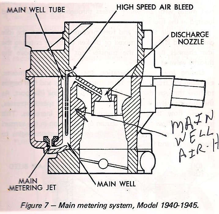

PostPosted: Tue Jul 13, 2021 9:05 am
Posts: 1603
https://www.carburetor-parts.com/holley-17-92.html OD is correct . length maybe 1/4 inch too long. This might work,call mike see what he says. A better picture would help, air bleed holes have to be there can not be just solid tube.

@emsvitil last night I was mulling over similar ideas. I found a lot of options for tiny brass tube stock online, a foot of a pretty similar diameter is only a few dollars, might be worth seeing if I can hold it gently enough in my drill press not to crush the tube and recreate it the best I can. Any idea how much I could mess up performance via having slight variations in well tube I.D.? I should be able to match drill diameter at least but I'll have to slightly increase tube size to maintain a press fit after drilling out the existing broken tube.
@matv91 I scoured through carb-parts and another site, I think it was quadrajetparts.com, and both had an impressive selection of odds and ends that aren't covered in standard rebuild kits like pressed in vent tubes and whatnot but unfortunately I didn't see any replacements for this well tube on the 1945. I'll keep searching later, I would imagine someone has them for places who refurbish or a different model used the same thing.
PostPosted: Tue Jul 13, 2021 4:56 pm
I don't see any problems if the ID area is greater than the area of the sum of the holes in the tube.
