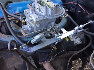

I have a 2150 with a Summit brand cable-actuated kickdown kit. I built a simple bracket for the throttle and kickdown cables that I can post pics of later if you think that will help.

I apologize for the delay, but here is the pic of the 2150 with the cable-operated kickdown with the bracket I made from 1/8" steel.
I hope this helps.
