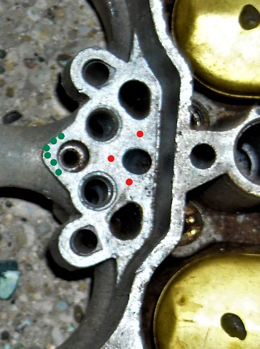

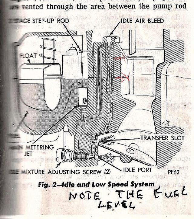

Posts: 1603
No specs from carter or chrysler for fuel level. So this is just guess work. Fuel above gasket line red dots in picturee, leak prone. Guess fuel level should be at least 1/32 below gasket line and 1/32 above accelerator pump ball seat, green dots in picture.

Posts: 1603
PostPosted: Sun Feb 06, 2022 3:13 pm
Posts: 1603
If look real close that picture shows fuel level just below gasket line.

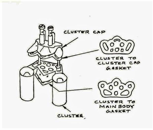

Posts: 1603
proper gasket from old tsbImage
