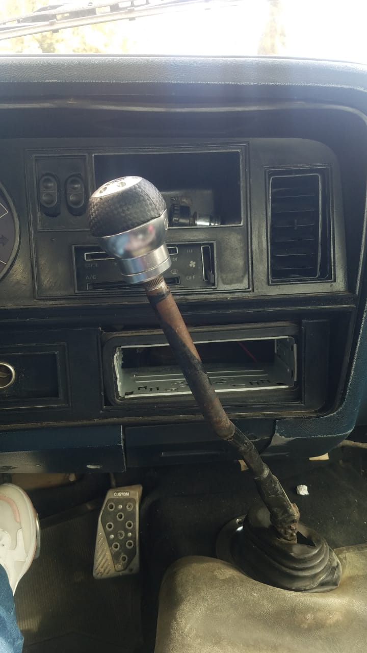

I'll have to check on the size. But if I want to buy another flywheel so I can replace everything. At rock auto they only have an 11 inch one, if my truck had a 10.5 inch could i replace both clutch and flywheel with an 11 inch or would that not work?

With the 833 OD transmission your truck will have the 10" clutch. The large "truck" transmission uses an 11" clutch. No 10 1/2" clutch behind a slant 6 that I know of.

I don't think I have the OD 883 transmission though

This is the picture of the shifter

You are correct that is not the 833OD

So would that mean that my truck has the 11" clutch ?

Probably, but there is an oddball "recessed" flywheel, clutch and pressure plate that they used also. These are not available anywhere that I have found including Chrysler. Here is the link to our problems and work around.
