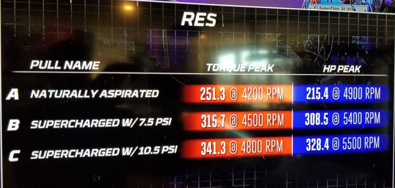

Steve built an, unknown size to me, 225 with flat top cast pistons, stock rods and stock cast crank.
Mild cam, Offy intake and clifford shorties were used from what I could see on TV.
The block was decked and the head shaved for 10 or 10.5 to one.
They used race fuel and around 30 degrees total on the first pulls, no blower.
Second pull was Torqstorm blower with a 750 Holley, 24 degrees total.

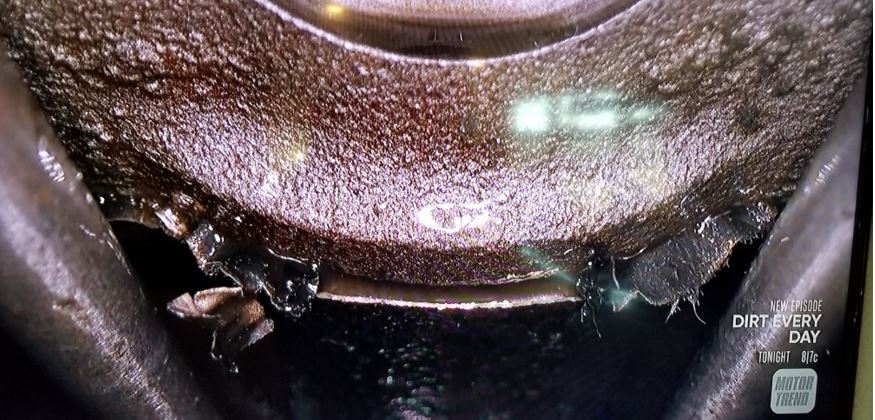

Head gasket blew out on number 5 cylinder on last pull.

And 328 HP is a pretty nice number. As a comparison that engine in my Valiant would be a low 12 second car. Not too shabby any way you look at it.

I have watch this segment a week or two before, and again last night. Dulcich's goal was to get a 225 slant to match the stock output of a 389 ci V8 the highest power engine available from the factory in an A body c 1967. He came real close. I don't recall if they listed the cam specks.
Dulcich likes a slant. All he had available was stock aftermarket composite head gasket. I suspect had he used a metal factory gasket there wouldn't have been a blow out. The other two guys thought for sure the slant burned a hole in a piston after smoke was exiting the valve cover vent and a compression test. But Dulcich maintained it was probably a blown head gasket. Once the valve cover was pulled one could see the failed gasket bellied out into the push rod cavity. It needed more clamping force, and a stronger head gasket.

They are not making tons of boost, although the CR is a bit high for a boosted motor. 215 HP NA at the crank is not much if the head was ported. 330 real HP is nothing to sneeze at, though.
