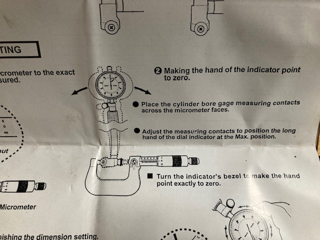

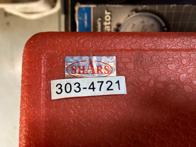

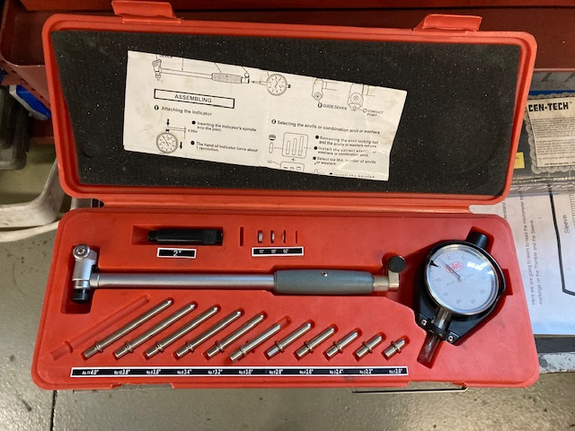

I have a Shars 303-4721 Dial Bore Gauge. With the selection of anvils and shims included it can cover a range of diameters.
The housing is sturdy enough, the gauge and the mechanicals have held up fine, but it does not get much use. I have built three slants and probably measured two others.
You do know that you will need a micrometer that is close to the size of the bore that you are measuring to set the dial Bore gauge up. That set up process also gives you practice on knowing what dial sweep is the correct measurement.
Note on the packaging they care enough about the dial that it is packed in a shock resistant case.

back when I was buying my garage gauges I ended up buying the Shars dial bore and micrometer sets. Shars was cheap enough that I could justify the expense vs use equation and they also have replacement parts and upgrades like electronic indicators available so you are not buying a one off gauge that can never be serviced.

I have one like John Posed up but I am not sure if it is branded or not. It has the same case and anvils - But the actual bore gauge is probably some offshore not mitutoyo unit.
