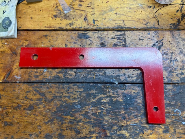

Since I have the front grill work and bumper off the 68 Barracuda, I think I want to add a front tow hook.
The front bumper is fiberglass with lightweight aluminum bumper mounts, and the front spoiler would really limit access to the k frame.
I am thinking of a simple 3/8 inch thick steel L bracket that would bolt to the passenger side sub frame where the bumper mount is, with the L forward and below the bumper with an eye on it for attaching a pull cable hook. Sound reasonable?
Any other ideas?

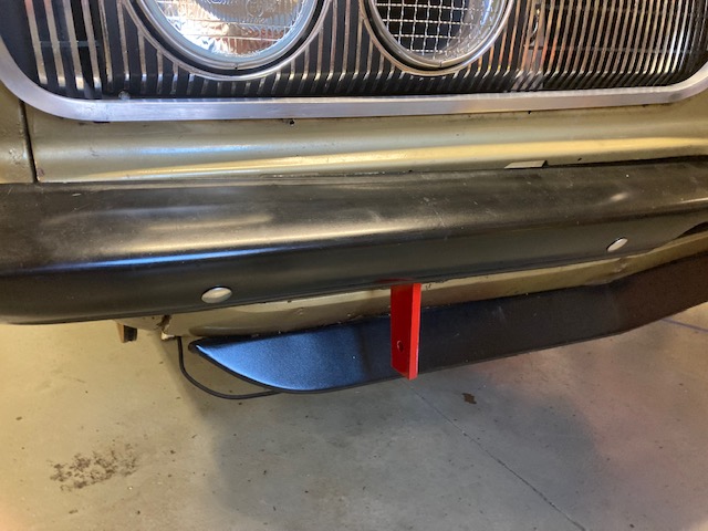

The tow hook is made and mounted. Weighed in at 3.8 lbs
I would have liked to use a strap like Greg did, but I needed it to get below the front bumper so in use the pull cable would not put pressure on the fiberglass bumper.
