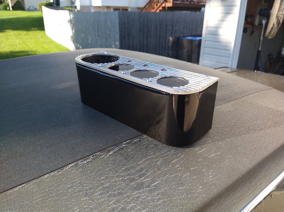

I had also made but did not complete the steel surround until around this time an under dash gauge cluster for the dart, It has provisions for a tach, oil pressure, vacuum gauge, and wideband O2, as well as 3 toggle switches with green indicator lamps
Made the steel surround from some 16 gauge hot rolled, tig brazed some nuts on to give me a mounting area for the panel.
And a quick slash of black paint on it
For the gauges I after many months decided on the Stewart Warner green line, all full sweep gauges, I had waited for over 5 months for the vacuum gauge on back order so a bosch filled its place for mockup. The toggle switches are L to R: Panel lights, momentary for the wiper pump (converted from a foot pump to stock electric repro), and toggle for a high idle solenoid for the carb.
So for my final project for trade school it was our choice to come up with something to make, most people made coasters with some engraving, one made a chess board, I made those manifold batwing's that I had drawn up earlier.

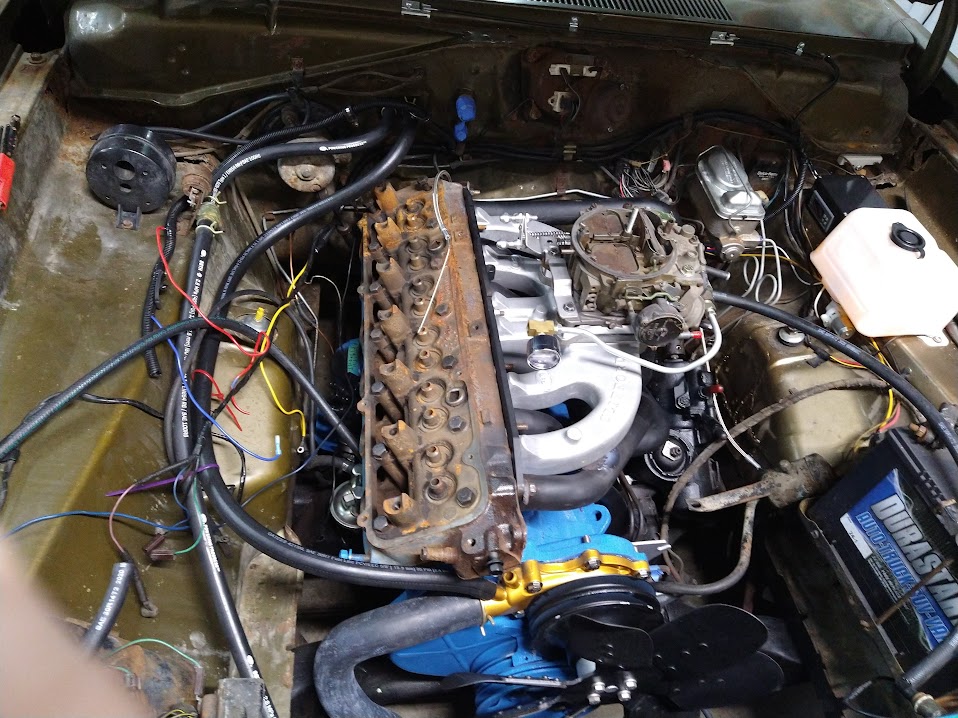

Then I dropped the short block paired with a junk head I was using for mock up back into the car to begin getting what I could hooked back up, figuring out my wiring, hoses, and linkages.
At this point I was planning on running the headers and a Q-jet on a modified adapter (a flipped spread to square bore adapter). That changes later, which I will explain later.
Since the Clifford manifold did not have provisions for a heat riser, nor did it have one for water, I though about it and took inspiration from my 3d printer, they use a low voltage heating element and are able to get the print bed to a temperature of 100+ Celsius with no issues, so I did some looking around and found some silicone heaters that are 12 volt that I thought would be worth it to try to give me manifold heat.
For anyone unfamiliar with 3d printing, it is a relatively slow process, for a print of decent size it is common to have it running for 24+ hours non stop, with that heating element at 100+C the entire time. So I reasoned that running a silicone element on a car that at most may be driven for 8 hours at the extremes should be quite safe, and it should be impossible for a silicone pad with a wire element to leak coolant or exhaust gasses too. These silicone heaters come in all shapes and sizes, voltages and watt ratings, and are sold in a 110 volt variety to adhere to an oil pan to warm the oil up too.
I used red hi-temp silicone to adhere it to the manifold after a thorough clean with iso alcohol. let it cure for a sufficient amount of time and its good and stuck on there. To control it I found a inexpensive thermostat controller that works on 12 volts and has a probe to read the temp to switch on and off. The thing I think may be an advantage of this is that you can change the temperature setting on the fly so if its hot out and the manifold heat may not be as needed, it can be lowered, and once the engine gets up to temp and the radiant heat helps keep things warm the heater will shut off, so it will be able to help regulate temps (hopefully!)

I suspect the electric heater won't be able to keep up with the heat loss from Missouri winter air constantly flowing through the manifold.
If it doesn't, you might consider a weld-on water box like this from Aussiespeed --> https://www.aussiespeedshop.com/product ... er-heater/
No doubt you could make your own.
--> The Diesel Corvette <--
PostPosted: Wed Dec 15, 2021 7:48 am
Online
Posts: 17670
Yes very cool stuff, Spencer. Glad the engine build is going well.
I have the same concern as ProCycle. 25 W is almost nothing in terms of heat. I would think something like 500-1000 W might be more like what you would like to have, and anything under 100-200 W is probably not helpful. I also agree that a water source teed from the heater hoses would be more sensible, since your engine is making/wasting 1000s of watts of heat just idling. Not trying to tell you what to do, but just suggestions...
