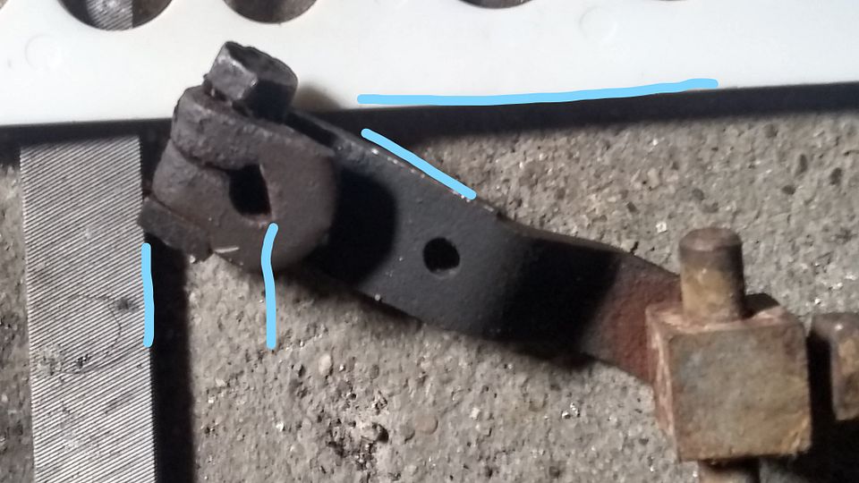

https://www.slantsix.org/forum/viewtopi ... 2&start=15 start about there there are pictures. 1974 onward standard parts same. before 1974 different body different lever d angle and lenght. back in the day things would get mixed up all the time |

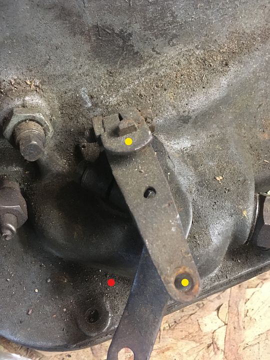

| Author: | matv91 [ Thu Aug 04, 2022 3:37 pm ] |
| Post subject: | Re: Kickdown / TV Lever length and slot angle. |
| Author: | matv91 [ Thu Aug 04, 2022 3:47 pm ] |
| Author: | matv91 [ Thu Aug 04, 2022 3:55 pm ] |
Thats your original note yellow dots ,with different D angle throws forward red dot |
