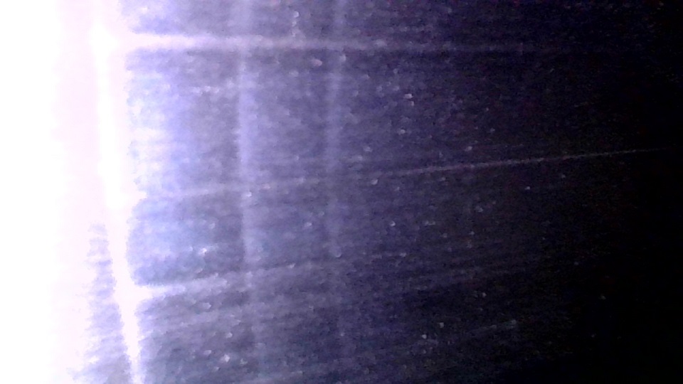

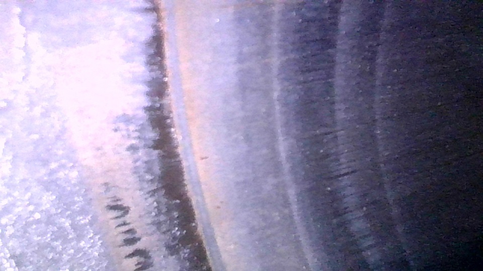

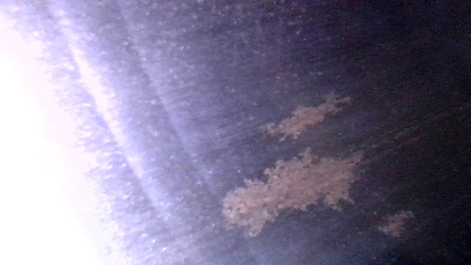

Attached are some boroscope pics. #6 is one of the 90% holes. What's that blotch? The others I got mixed up... I believe #10 is one of the 40% holes. You can see what appears to be deeper vertical mark towards the top. Yes, pics are rotated.
Is it possible these vertical marks are normal and I'm just chasing my tail .... or are any vertical marks a no-no? Reading random opinions online seems they are mixed but agree that any felt by a nail are a no-no. Gut feeling says the heads coming out. Is it normal for leakdown to be this significantly poor but compression good? I repeated the leakdown test a few times to verify it wasn't a testing error.

I see the compression Ok (or a little low) and the leakdown bad quite often working in the mower shop. I think the volume of air being moved by the piston is so large it overcomes the "leakage" and it still builds compression. Put the piston at TDC and do the leak down and all the leakage shows up.
If your leakdown test is bad probably the grooves are affecting you. Where do you hear the leakage from? The spot sure looks like rust / corrosion to me.
