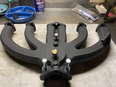

Hope this pic satisfies the curious minds out there.
File comment: Cortez intake
The YH has a threaded port below the choke throttle controller Bakelite thingy. There was nothing attached to it. I can add another pic of that but don’t want to over-do the pics as per the facs. Maybe this is more of a topic for a Corvair forum?

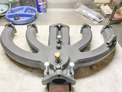

That threaded port is for the choke's hot air tube—different length version of the same tube that goes to the throttle body in this system.
The other interesting thing about this intake is the plate that bolts to the regular top-surface carb mount pad. It's not just a plate; it has a fitting for the PCV hose, and a big metal extension that protrudes straight down into the intake plenum, apparently to put a hurdle in the airflow path from the carb to the middle cylinders (presumably so they wouldn't run too rich and the outer cylinders too lean).
Here's an exposure-adjusted version of the photo:
Lucmajuke, please feel free to upload more pics; you're nowhere near posting too many!
