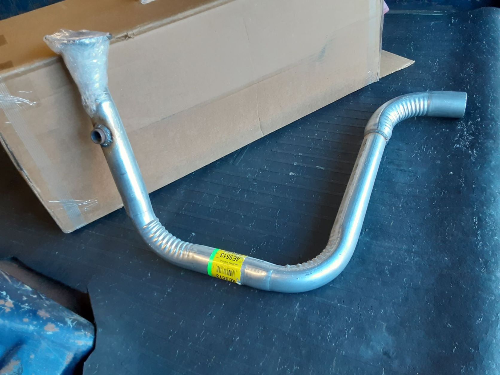

(update after much deliberating/attempt at part hunting) if anyone is looking for the down pipe without the cat. for the slant six on d100/d150 Waldron can custom order you one for a decent price (165 plus the ride). I believe its similar to the old walker exhaust 44958 that is no longer made. Looks like it should fit my 86 pretty nicely.

Waldron? Huh?
What's the pipe size(diameter) of that one? I made one from scraps for mine a while ago, started with an original stub I got with a super 6 manifold stack and raided a scrap dumpster at a local exhaust shop, had some stainless (whatever grade OE exhaust is on newer vehicles) 2-1/4 pipe in there that was taken off of who knows what, looked like it wasn't far from brand new, I cut all the elbows out of it (kinda like a summit or jegs DIY header kit) and eyeballed it on my truck and mig'd it all together. I did a decent job welding and positioning what I had but being it's 4-5 short sections welded together from manifold to muffler inlet, but it looks the part (cobbled)
