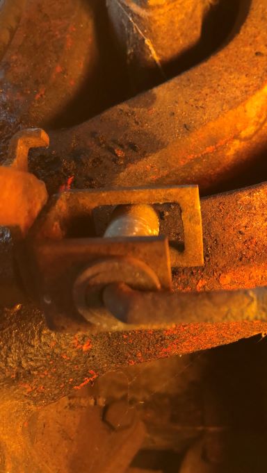

I am replacing the old 1BB carb on 63 valiant. Can someone tell me how the throttle linkage is supposed to be disengaged from the carb? I don't want to break anything lol.
Pic attached
PostPosted: Tue Oct 25, 2022 12:58 pm
Posts: 17617
I have always pulled the bent metal rod out of the rubber/plastic bushing. I wonder if a little silicone lubricant (NOT WD40 or penetrating oil or motor oil) would help make this easier.
PostPosted: Wed Oct 26, 2022 8:09 am
Posts: 10386
I have just pried them out without any issues.
