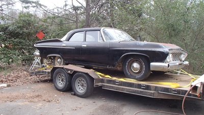

The Car
Here she is as the day I bought her
