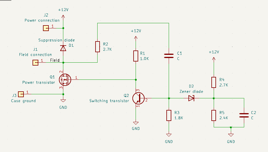

I was able to draw up a better view of the existing schematic. (Note - I forgot the capacitor between pins 2 and 3 of Q2, will need to add that.)
One way you could get more accurate voltage with a factory-type regulator would be if you used the field coil wire to trigger a relay to power the regulator from the battery. If I created a regulator with a few more pins, though, it could handle the switching internally with a couple extra transistors. It may indeed be a crutch... but there's a lot of voltage drops through 40 year old wiring, and adding a few extra parts can be less trouble than chasing all them down.

PostPosted: Sat Aug 12, 2023 11:34 am
Posts: 25012
Wouldn't a similar purpose be served more easily by doing as Chrysler did on their heavy-duty charging systems, bringing the alternator and regulator electrically closer by using a field-loads relay? Really easy. Get a good-quality, name-brand relay. Find the wire that presently feeds line voltage to the voltage regulator when you turn on the key. Cut it. If you've got the '70-up system, cut it upstream of the splice that also sends line voltage directly to one of the alternator's field terminals when the key is on. Upstream end goes to terminal #86 of a relay. The regulator/field end goes to terminal #87. The #85 terminal gets grounded. The #30 terminal goes to battery + (via an appropriate fuse of about 5A to 10A, depending on alternator spec). This way, turning on the ignition shows the regulator the actual battery voltage, not line voltage after dropping through the notoriously high-resistance ignition switch and master wiring weld under the dash (plus firewall connector, etc).

Dan - yes, that's a more detailed write up of what I was suggesting with the relay. If developing a regulator that uses a different plug and wiring, it would also be possible to do this internally with MOSFETs instead of a relay.
