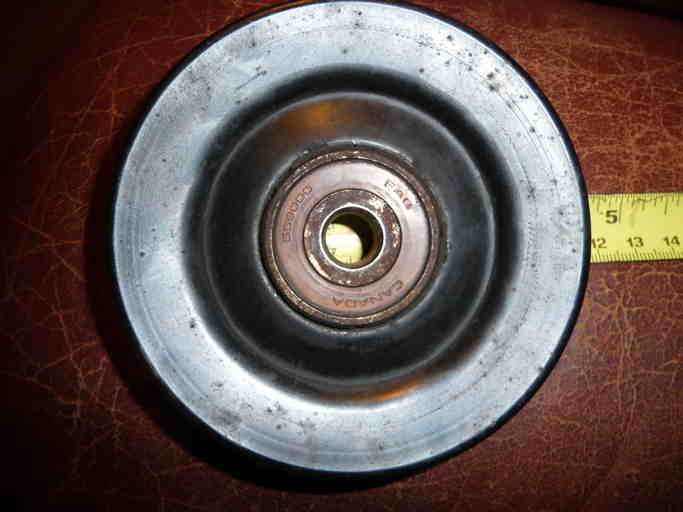

Removed the pulley (again, after trying to shift its lateral position) and spun it by hand: basically smooth, though there are slight knocks at one or two places in the rotation.
Here’s the pulley in question:
4 1/4" O.D., 1/2" center hole
This vehicle originally had air conditioning. One memorable northbound Interstate 5 trip, the air compressor, which at that point was doing nothing other than being an overweight too big idler pulley, broke 2 of its 3 mounts. Removed the belt and compressor, and drove on. (Yes i did cook at least one of the catalytic converters. That’s another story for another time.) That very same day soon as i was near a major metro area with a Dodge dealership, i dropped by the parts department and got the official idler pulley hardware for vehicles with an air pump but no air conditioning.
Seems like the bearing could be pressed out and replaced, but i’m wondering whether it would be better to seek a 4 1/2" pulley, to get a little more of a gap between the belt and the timing tab bracket. I know nothing about how easy/difficult it is to find more or less what i would think is a generic v-belt pulley of the correct size with a decent bearing.
Only as a test, i’m thinking of spraying in some high-quality lubricating oil into the bearing and remounting the pulley to find out if it can be quiet for a couple of minutes at the high idle where it has been so noisy, to verify that tor problem is indeed the pulley bearing.
Thoughts? Ideas? What would (any of) you do?

Thank you for your thoughts. In terms of the noise, i’m still thinking pulley bearing wear, triggered by my tensioning the belt far tighter than it had been. It had been loose before and tended to slip when the engine was first started. When i looked up the part number for the pulley, which was also used in some Jeep models, there were many reports of noisy bearings and seeking replacement pulleys or bearings for them.
In terms of insufficient clearance wear near the timing tab, i think it may have been like this for a long time and i just recently noticed.

Brief follow-up: the noise was indeed the pulley bearing.
Found a Gates 38040 works. Slightly larger O.D., otherwise fits nicely. For my particular engine there is enough clearance for the larger O.D. (123 mm vs. 108 mm for the Chrysler original part), and this moves the belt slightly further away from the timing tab.
Since installing this pulley, the engine again sounds the way it always has in the past, when running correctly.
