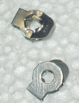

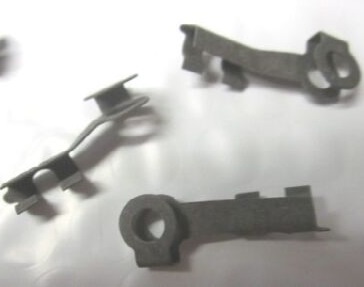

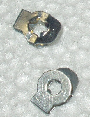

Thanks for the reply and the resource. Attached are some reference pics I found for someone with a similar question.
I have a bunch of stick time on QJets and was thinking of this style clip (which is also found in different sizes for door linkages etc)

I believe this is the style that I was looking for (like a pal nut almost)
Yep, that's the correct type. They come in lefty and righty; you need the correct-handed clip so the choke pushrod enters the choke lever from the rear, with its end pointing forward.
