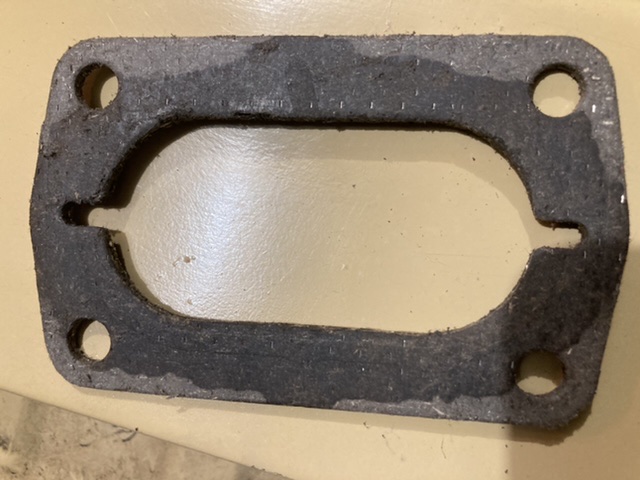

Bowl Vents do not appear blocked by the gasket or air cleaner housing.
Thin gasket I took off appears stained?

Tighten the screws accessible from the underside of the carb before you put it back on.

I bought a NOS 318 V8 BBD for my super six at 1999. It was running right out of box but leaked fuel all around like this. Mostly after engine shut down. In that carburetor the problem came with casting quality. The gasket surface was not complete and there was opening outside of the carb. I parted that carb and hey'd the casting with sandpaper over a flat glass. With new gasket it was fine then. Have you opened yours to see there is everything well inside?
